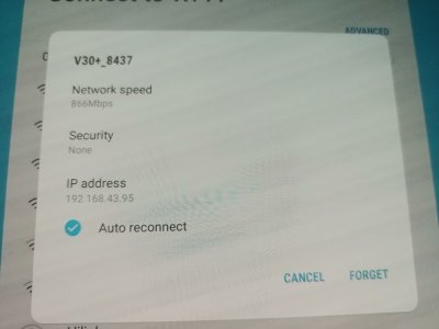

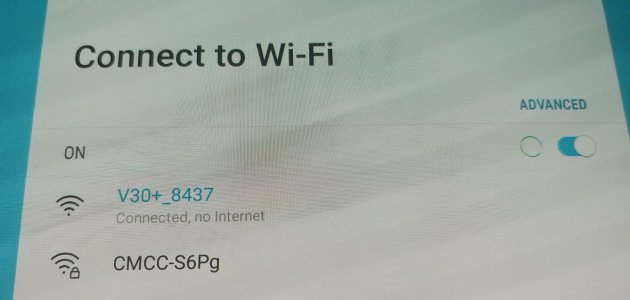

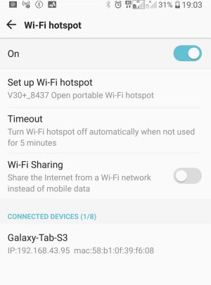

Hi Again. So turned off my security on my hot spot on phone so connection was open no password required and same problem.
Connects to phone shows up with address. Connected on Tab3 but no internet.
Really running out of ideas. Can you root the device to bipass the need to connect to wifi just to turn it on? Is there another firmware that's better ?
Couple of screen shots attached.
Cheers
