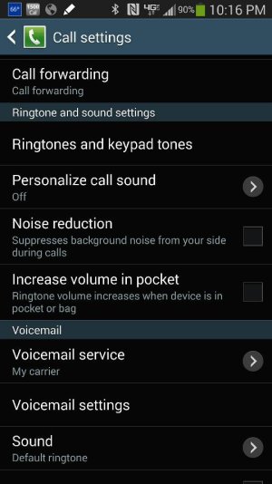

One quick question for all the garbled callers. Open your dialer and click the menu then settings under ringtone and sound settings, do you have noise do you have noise reduction checked or not. I have a feeling you may have the noise reduction checked. Uncheck that and see if the quality improves.

Yes it is only on the note 3 side of the call, that is why I think it is the noise suppression setting causing it.

I don't believe it's the call privacy, I notice this problem when I went to call setting and change the personalize call sound. When I bought my note 3 it was off, when I made the change to soft that is when I notice this issue. But as long as I keep it off or on clear the quality is great. Maybe if people who are having this problem should check there and see if they are still having this issue.
No not call privacy, noise reduction. And the clear etc you are talking about is a part of the digital noise reduction. See the image I attached. 1383358813924.jpg

No not call privacy, noise reduction. And the clear etc you are talking about is a part of the digital noise reduction. See the image I attached. View attachment 89777

This isn't the cause or solution. I've had the problem while both checked and unchecked.

Ok maybe each phone is different but I keep my personalize call sound off, no issue. Sound quality is great. A lot of people on sprint had this issue, Samsung released an update last week so far so good. Let see if or when vzw will have an update.
