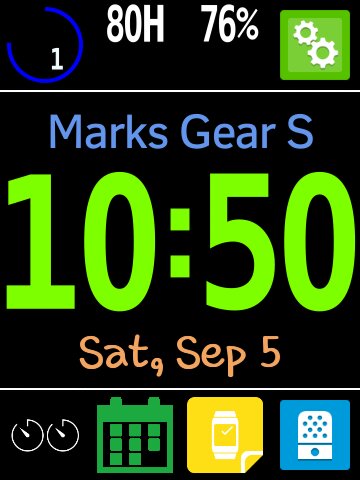

I've had mine unplugged for 13 hours at this point and it's at 71%. I've made one short phone call with it and responded to several texts, maybe checked a couple emails. It's been on BT the whole time to the phone. How much are you keeping the screen on?

Unplugged since 6am this morning. Remotely connected 8+ hours at work. 12k+ steps on pedometer. Probably 2 dozen gmail, about a dozen text.
A normal day for mine.
