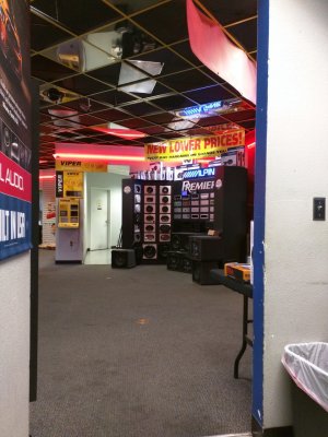

I have 2014 Stingray and there's no way I'd ever consider putting an aftermarket head unit in it. Stuck a 4100 in my 14 Malibu it it was a pain in the ***. Actually I'm at the install shop not for the third time. I don't even want to think about the gremlins I'd find attempting this on my vette...

Sorry, I literally replied to your post at the install shop and was kinda rushed. With newer cars swapping radios it always seems like you lose "something" - a feature, a control, an adjustment etc etc. In regards to my '13 Malibu I lost the ability to adjust alarm and light controls and some other odds and ends. It's not the end of the world but it can be really aggravating...
