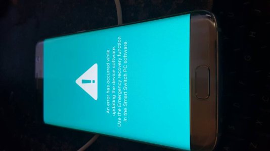

Well somehow I messed up and now my phone is stuck on a error screen. Nexusgirl I did try the smart switch way and it wouldn't . I tried several times using different YouTube videos and I keep getting fail through Odin. I should have just left it alone. Smh
Phone is still stuck. Oh well I'm glad I still have my note 5 as a backup until I figure out what to do. Lol
