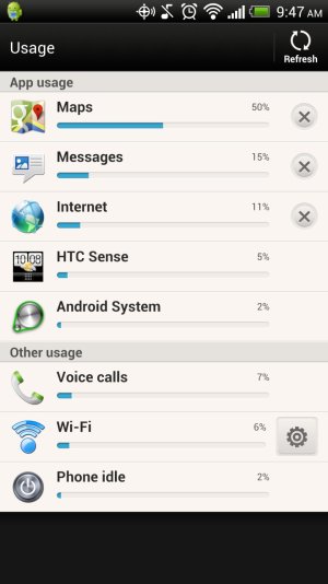

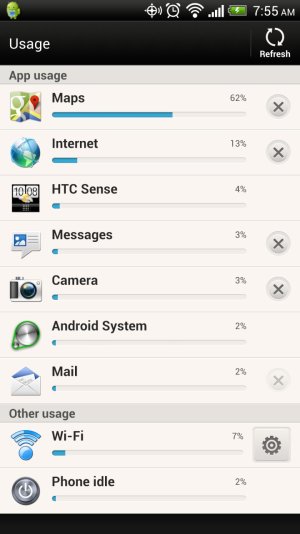

My new DNA has pretty terrible battery life. When looking at the battery usage, it looks like Google Maps is the culprit.
I have not opened the maps app and use advanced task killer to close apps constantly.
I turned off Google Latitude and still have abysmal battery life. I cannot make it through a basic workday without the phone draining to almost nothing.
Anyone know what is causing this?

Thanks, but the Maps App is obviously being activated by something and it is using a disproportionate amount of my battery versus everything else. I think that is my main power problem.
Every time you force close maps it will restart usually automatically and will definitely kill the battery. Also other apps and the browser I see in the screen shot uses location check settings in popular apps that you use and turn off their location settings. I hope that helps a bit.
