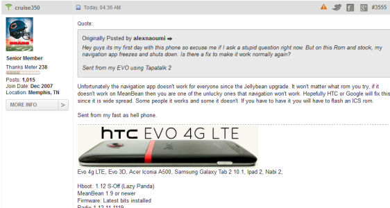

The nav problem seems to be a bigger issue than expected. While ROM devs over at XDA have been able to fix the proximity sensor issue as well as some other bugs brought about by the JB update the general consensus on the JB navigation issue is to roll back to an ICS build ROM.
