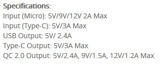

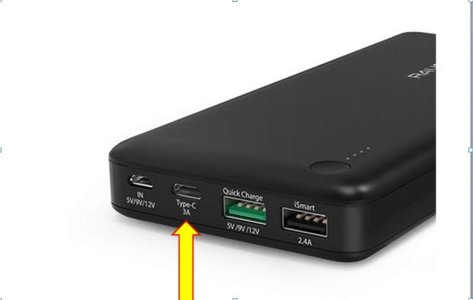

Despite this is car charger thread, there is RAV 20100 power bank with USB-C 5V/3A input/output ports. Let's wait until somebody test it.
Re: nexus 6p car charger
That RAV powerbank is 2.4A. Anker has USB-C options "Coming Soon". Whatever that means.
Ugh, right. Guess I missed that part. Damn.
Oh well. Looks like I'll just wait!
I wonder if one of these USB Y adapters along with a very short USB-A to USB-C cable would allow the device to pull max current from a pair of 2a USB ports. If anybody has these pieces laying around, please give it a try and let us know.
I might just order them, but I'm having trouble finding a super short USB-A to USB-C adapter. I do have a USB-C to female USB-A USBOTG cable (7-inch), but that would require yet another link in the chain... a USB-A gender changer. Still, I might try it just for fun. If I do, I'll report back.
I stand corrected. I only saw the USB output at 2.4A
