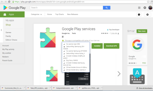

Instead of trying to update on the phone itself, try going to the Google Play Services page on the Play Store website on your computer browser (not your phone browser): https://forums.androidcentral.com/e...d=com.google.android.gms&hl=en&token=UQeM3Aio. Tap Installed--does your Note 3 show up in that list?

Update. I found a solution.
I went to the google play store and downloaded an app called 'google play service info' (AFTER I did another factory reset - I didnt connect to the internet and disabled any restoration and syncs for apps etc.. I needed to do the google play service update first).
Before I did anything with the newly installed app I went into my: Settings, Application Manager, All.
I looked for 'google play service', and clicked on it.
I looked at the number in the bracket up the top. It had numbers followed by "-438" the number you have is important and is explained via the app (google play services info).
I read through the WHOLE lot PROPERLY and what it says (for example) is that phones who had google play services with the numbers after the minus/parentheses that were -438 (there were two other sets of number versions mentioned too)... had infact changed for some reason. Its just the first number after the minus that is different. Example for mine being -438 it had changed to -238. The other two sets now have a different firsr number too.
I downloaded and installed the latest apk that was -238 and BOOM! Problem solved for me.. I was then able to update all my shizznit. I did notice that the lock screen pic that I chose doesn't quite fit and looks stretched out however that aside I havent found any issues with anything, I play pokemon and thats all good, youtube is fine, Gmail is fine etc...
I was super hesitant to download the apk, however, its done, my phone isn't a crappy piece of crap and I'm happy.Google needs to sort their **** out! Ammatures!

Thank you Jmyhers!
Followed your advice, found the lastest -238 google play service, installed it and no more error!
The version i downloaded was v8.4.89(2428711-238)
Hope this works for everyone else!
