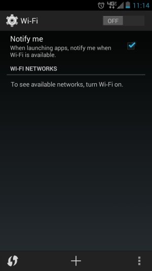

That's my point. My WIFI was physically turned off in all those screen shots.
Did you check the advanced settings of WiFi? If so, was "Scanning always available" turned on? See my post above, #15. I think if you have that turned on, the WiFi radio will be kept available for location services, even if you have the WiFi radio switched off. And, not to sound like a broken record, but if you have *not* switched the radio off in settings / WiFi, then it will also be listed as on, even if you are not connected to an access point.
Just confirming, this means my wifi radio is off right?
Also, I've had location services turned off the entire time.

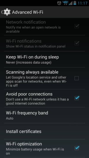

This is how I have my wifi settings configured.
This morning, when I first noticed the problem, I changed the "wifi always on during sleep", to never. Prior to that, it was on always.

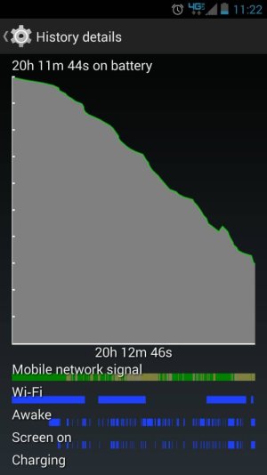

As you can see from this screen shot, at a certain point, the wifi stopped running, which I think is normal when the wifi is turned off in the settings.
I want to clarify that when the graph says it was running toward the latter half of the day, my wifi was on and actually running, because that is when I got home, however at all points before that last period my wifi was literally turned off the entire time, except for about 1 minute when I was testing something out.
I don't understand why it was stuck running in the beginning of the day, but it seems to have stopped for now.
Hopefully somebody can shed some light. I'll send an update in the morning, but I'm starting to believe there was something weird going on this morning despite clearing the cache and rebooting.

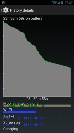

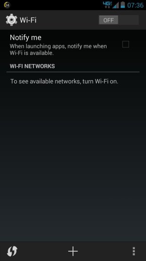

I would say that something is odd with your wifi connection. Here are my screen shots from this morning, I turned off my wifi about 12 hours ago.
