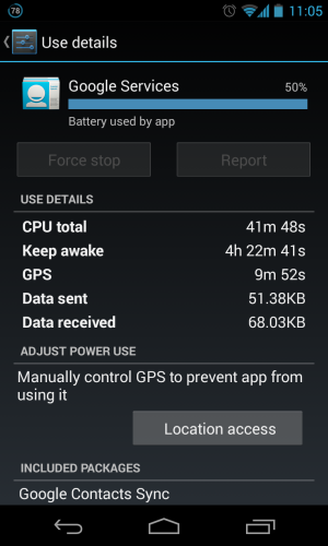

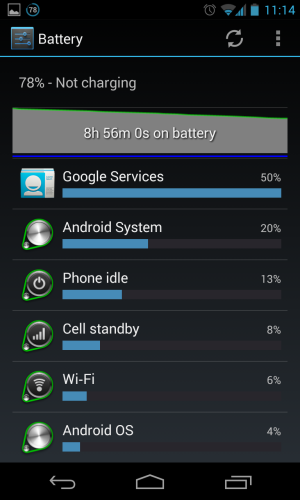

hi,
last night before i went to sleep my phone was on 100% battery.
in the morning, it went down to 78%. never had has much battery drain over the night, all thank to google services.
I've had similar problems. For me I had high awake time due to a location process. You seem to have high wake lock times too with 4+ hours.
I downloaded the wake lock detector app on the Play Store and found it to be a location problem. I've disabled Google location reporting as that was my main culprit, especially with Google Now activated. Now my phone is in deep sleep 84% of the time as opposed to 0%. My awake time would be the total time since unplugged literally.
But to know what exactly is triggering the wake lock on your device I recommend downloading the wake lock detector app and follow the simple instructions provided in its description on Google Play. It should reveal what process is triggering the wake lock. Mine was "nlp collector location" or something like that, part of Google services. Google now seems to be the main culprit as it is off now but location reporting is on and the problem has not returned. Google now uses primarily location reporting to function and i believe the app was causing excessive location reporting.
