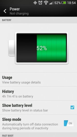

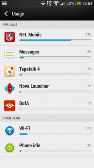

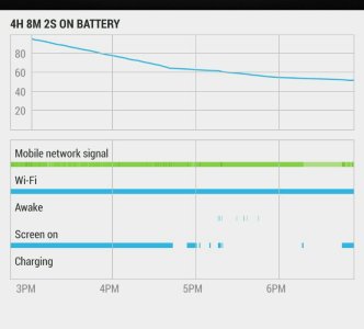

I have been having bad battery life. I decided to do a factory reset. I put all of my apps back on but left Google now disabled.
Wow! It is like night and day. Ten hours of regular use and still have 40% left. Yeah I think I will leave Google now aloneB-)
Sent from my HTC6500LVW using Tapatalk 4
This is today with heavy use of Red Zone on the VZ Nfl app.
Did I miss something? This is the Nexus 4 forum and you are showing screen shots of an HTC device? There is really no way to compare the 2 when it comes to battery drain. The software between these 2 devices are like night and day...
On wifi all day yesterday on my N4 running 4.3 stock rooted with stock kernel I got 6 hours of on screen time and unplugged for about 14. When not on constant wifi, I cannot pull anywhere near those numbers, if I could then that would be more then pleasing to me.
Because I was having the same battery drain problems and this thread helped me fix it.
