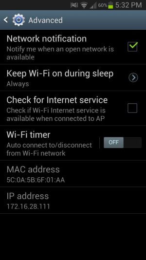

Go into settings and allow wifi to stay connected when in sleep mode
sent from Galaxy Note 2
Thanks for the tip. I changed this setting on both phones. Did this functionality change with 4.1.2? I don't recall having this issue until the 4.1.2 update. Regarding battery life, shouldn't we expect better battery life by letting WiFi stay connected in sleep mode vs trying to connect to 3G? Both phones are set up to sync with an Exchange email server via push, and thus will be frequently connecting after the screen goes dark.
I think that's what kgk was saying. Turn sleep mode off, so WiFi stays connected during sleep. Keep WiFi on during sleep should by set to "Always."
What Meyer said. It will help a lot when wifi is staying on constant versus dropping and reconnecting a bunch. Just ensure its set to always and that will help.
