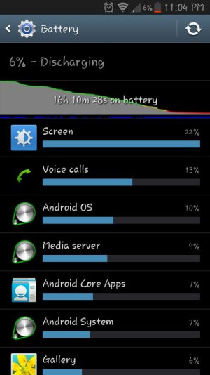

I have concluded that I HAVE to be on power saving mode all day to get through my whole day 7am to 7pm on one charge. Otherwise I will only last from 7am to 4-4:30pm.
Here is a pic of yesterday's graph IN power saving mode with moderate to somewhat high usage.

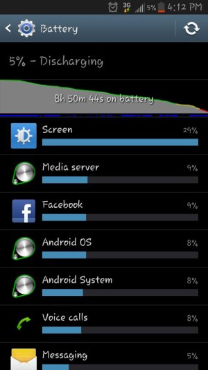

A pic from today's usage on power saving off. So a good 3+hrs difference. What good is it to have a powerfull phone if u can't use it without it lasting a full complete day?! Horrible....

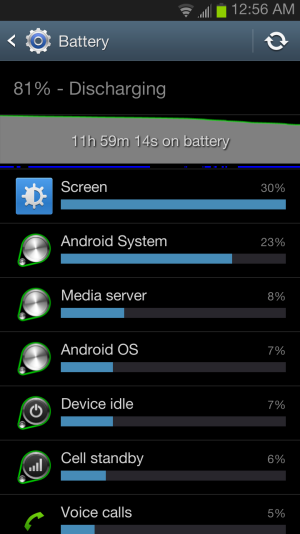

Screen on time is definitely a good point...I can save a ton of battery by not using my phone lol. For the reference, the photo is 39 minutes of on screen time today haha
I had it on wifi today, but didn't use it too much (few phone calls, texts, check facebook lol) this is stock JB...
I turn Google Now off, and I make sure location reporting is disabled in Maps...I typically get about 3-3.5 hours of on screen time. I never use any power saving mode and I don't use any battery saving apps...
