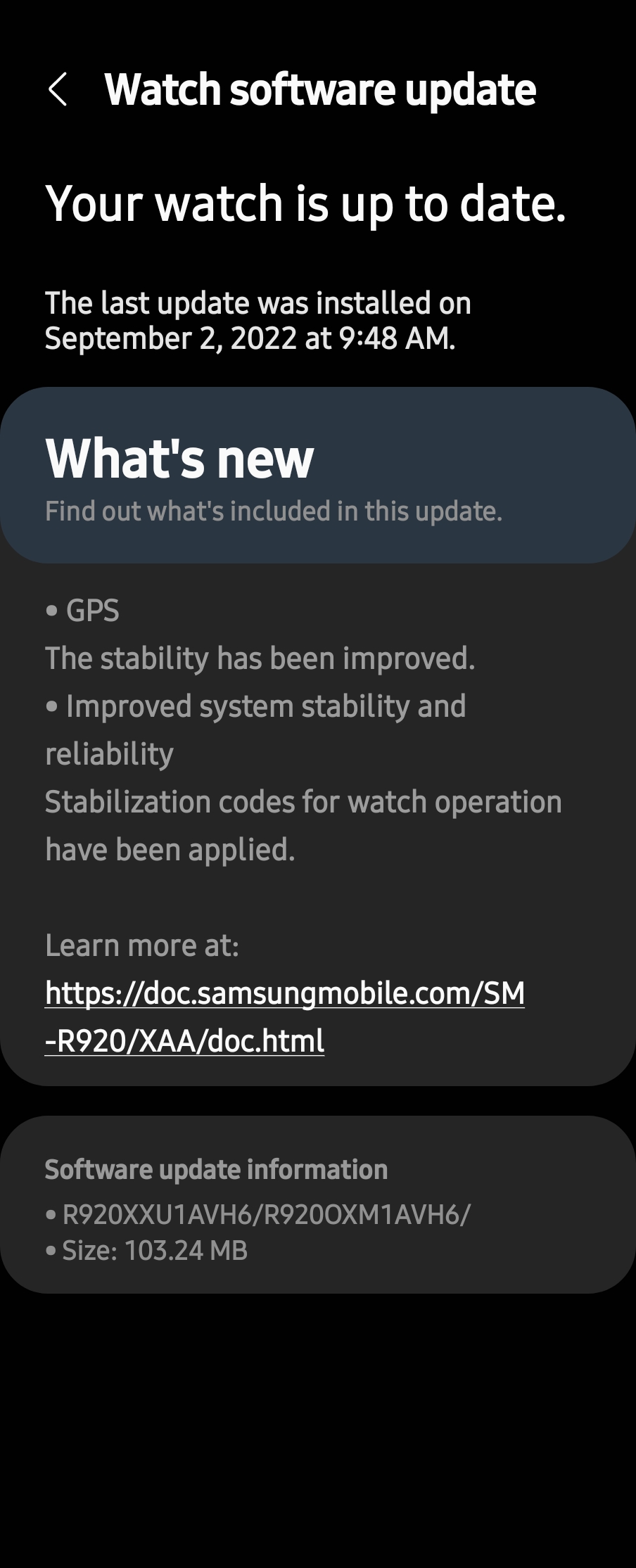

There was an update dealing with GPS that hit my watch today. Those with GPS issues has this hit your watch recently? Did it help?

I received no update, and I just checked to make sure I am on current software. TBH, the GPS tracking is god-awful. I mean, horrid. I run on a paved rail-trail, so you can't really get much more of a straight line than that, and my route looks like a drunken cat, sometimes 20 to 30 feet off the trail and almost never in a straight line. I'm keeping my watch simply because (a) it was cheap enough with the T-Mo discount and (b) it provides me with the security of LTE coverage when I'm out running far from help, but as a "sports-watch", the Watch5 is SO far under what else is available. I simply don't understand how two companies the size of Samsung and Apple cannot figure this out. What is Garmin doing that they can't?
Yes I just checked I have an update also and it mentioned GPS
