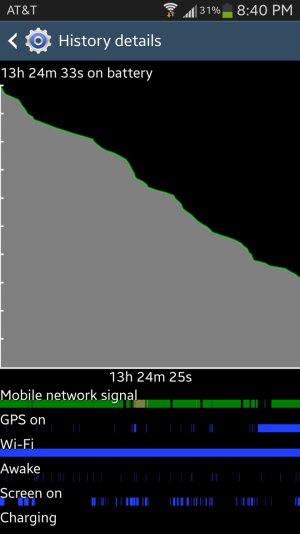

GPS will not turn off. Did a reset. Fixed, day later problem returns
Calidoc
Apr 3, 2013
171
You can see from the screen shot the GPS was constantly on ALL DAY, even when I manually turn GPS off. I did a reset and everything seemed normal (see other screen shot). Now, as you can see, the last 2 hours the GPS has been on constantly and will not stop even when I turn off GPS.
I already did a full reset yesterday. Do I just need to take it to AT&T at this point? Will they swap it out in store if they think it's a hardware issue? Any other advice? This is frustrating.
And I made no changes to anything. Everything was normal today and all of a sudden the GPS won't turn off.

When I restored, it worked normally for most of the day. This, after reinstalling my apps. Then tonight, the GPS wouldn't turn off. I made zero changes at all from the beginning of the day to the end.

So, I just uninstalled every single app. The only apps on the phone now are stock apps. GPS is manually set to off, but still is listed as continuously on GPS On in the battery graph. Any ideas? Does this indicate a hardware issue?

That's what I'm doing now. But I did this 2 days ago and everything was fine, then it started again. And it doesn't make sense that even when I manually turn off GPS, that an app would keep it on. I just don't know if its hardware or software. I'm tired of trying to sort this out already. I wish AT&T would just do a swap.

According to my stats, it uses hardly any CPU. And the only one I'm using is a date widget. So far today, the issue hasn't occurred. But yesterday was fine until the evening, then the GPS went nuts again. <fingers crossed>
