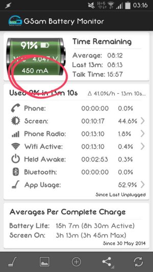

I've been struggling with battery life for a while so I installed GSAM to try and assist. On attached pic is the circled bit the actual capacity of the battery? If so, I assume it should read 3200Ma after a full charge. Or is it me being dense?

That's the charge rate, not the charge the battery holds. When plugged in you will see varying rates according to how you are charging. When unplugged, unfortunately, it stays at 450 instead of showing the discharge rate.
I have asked that several times in different "my battery is dying" threads.
Is there a technical reason why no app gives the available capacity of a well used battery. Is 3200mah always available, but it doesn't discharge as effectively or something.
It would be easier if a new battery would show 3200, but 9 months later it has 2600 available. That would be easier to understand.
You would need to use external hardware to accurately measure the battery capacity.
You can use various calibration apps that can estimate through calculation what the battery capacity is but there is no way of knowing how accurate the result is unless you also use hardware testing.
Some phones can be more accurately estimated than others based on whether the manufacturer has allowed direct system reporting of the current. Two manufacturers that have historically not allowed this are Samsung and Motorola. Others may be on a case by case basis.
One app you can try (if you want) to estimate battery capacity is Battery Monitor Widget Pro by 3c. There are other apps as well. Make sure you follow their calibration instructions exactly. Read ahead of time, especially if it involves a purchase, to make sure you are willing to follow their instructions.
