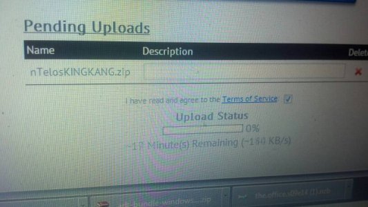

You can get a Drop box account and upload it there.
Sent from my Motorola RAZR MAXX using Tapatalk 2
Yeah if you guys want me to try to make something work for you I need that file.

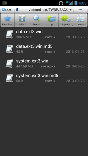

I rooted using 1.82 like you said - no problems! I also loaded SS 3.11, and did a b/u but I don't see that file anywhere. Does 3.11 make a different file name and put it in a different folder? Let me know and I'll get it to you asap.
Thanks,
Bob
Your backup will be on your SD card in the TWRP folder.
