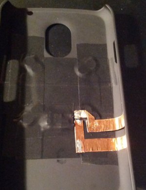

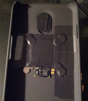

Just completed this mod on another style of case than the one I originally did the mod on (Diztronic Matte Back Black Flexible TPU Case). This second case is the Qmadix QM-HLSMI515-SO I picked up from Amazon for less than $5 about a week ago.
The only problem I ran into with the Qmadix case and which had little to do with the mod is that I use the extended battery and the Qmadix would not fit on the phone unless the battery cover was removed. I opted to cut in half an extra battery door enough to cover just the top part of the battery instead of just letting the case hold the battery in (with the help of some elec. tape, which also worked very well).
Both times I used copper tape to make my circuitry, soldering any joints/routing points and taping off with elec. tape to complete it. I've attached a few pictures (fully taped, ready to go / routing of copper tape circuit / in progress, initial taping after components were in place).
I'm glad that all of these old webOS TouchStones still have a purpose around the house, car and office.
