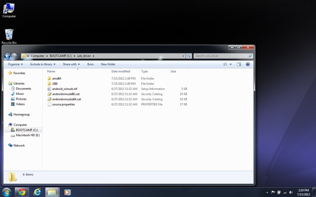

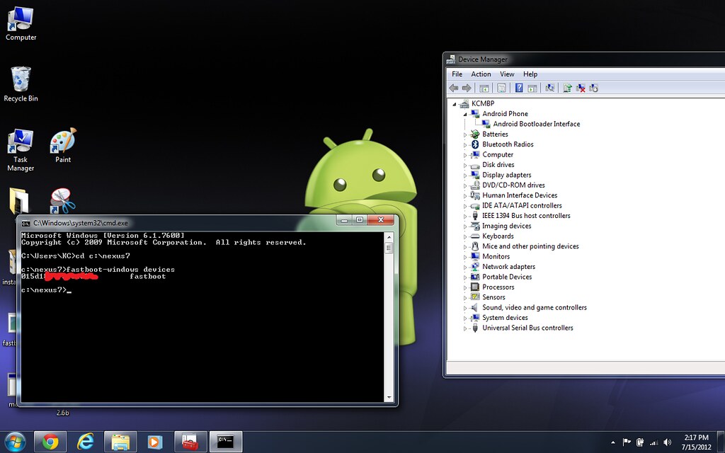

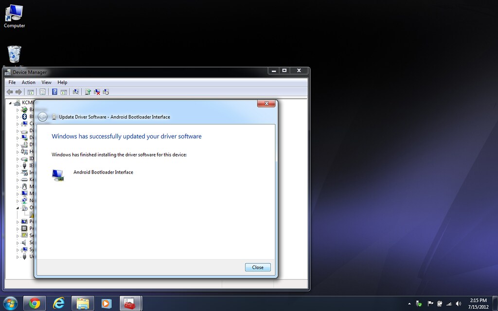

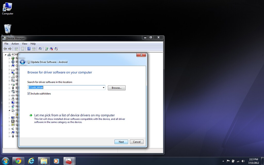

Re: [GUIDE] How to Unlock and Root the Nexus 7
For future reference, I took some screen captures on how to install the drivers.
1) download universal naked drivers
2) unzip drivers (I chose to unzip them into the "C:\" directory)
3) get Nexus 7 to bootloader screen
4) plus in Nexus 7 via USB to computer
5) follow pics below
