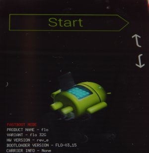

3. Keep holding Power and Vol Down until you see this screen:

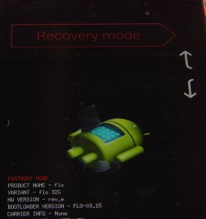

4. Use the Volume keys to select Recovery (press Vol Down twice), and then press Power.

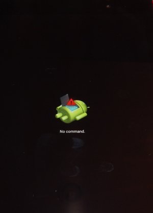

5. You'll see the Google logo appear for about 5-10 seconds, then our little friend will show up looking a little piqued.

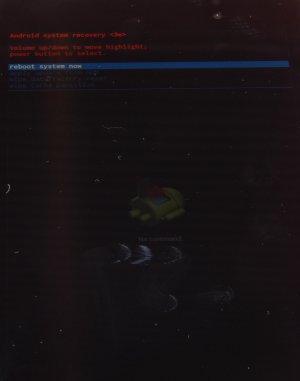

6. While pressing and holding Power, press the Vol Up button, then release both buttons. You don't have to hold either button down for very long. The Recovery Menu will now appear:

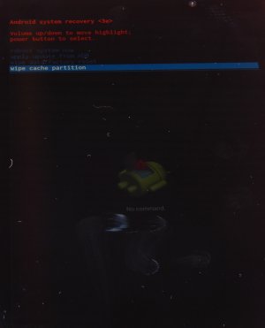

7. Once again, use the Volume buttons to move the cursor up or down. Press Vol Down 3 times to highlight "wipe cache partition," then press Power to execute.

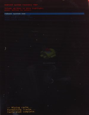

8. You'll see some notifications about the progress at the bottom of the screen--it shouldn't take any longer than 10 seconds or so to complete. When done, the Recovery Menu will appear again, with "reboot system now" already highlighted.
9. Press the Power button, and your Nexus 7 will reboot, hopefully with a little faster and smoother performance!

I am on 4.4.2 and get stuck on step 6, it wont get past the No command screen to enter the Recovery Menu if I press power and Vol up.
EDIT....ok it does work fine, but the above step 6. should be worded diff. When you press and hold the power button, then press the vol up button and let go while still holding down the power button. I figured it out from watching this guy do it to a N4 watching this guy on youtube
