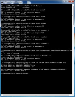

Now its my turn! I have been at it for last 18 hours straight trying to wrap my head around.
Once upon a time, 18 hours ago....I was reading a book on N7 when it just went off. I thought the battery must have died. Left it on charge overnight. Turn it back on in the morning and get the "X"!
I have tried most suggestions in this post and from other posts too.
Long story short, I am able to get into "fastboot" mode.
I am able to get the serial number response from "fastboot devices".
I am NOT able to go any further (CANNOT get "fastboot oem unlock" to work which would be the key to this entire theatrics).
To save all a lot of reading, I am attaching image.
Any genius's out here who can trump the fat fallen Android?
Well a factory image restore is meant to recover your device when you screwed something up hacking at it. Yours just turning off while you're reading is not related. Sounds more like hardware failure to me, though I can't say for sure.
