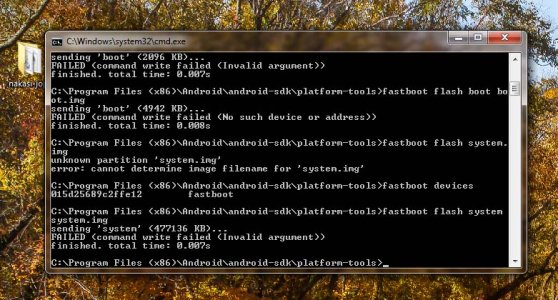

I dont know what is going on. I was using the Nexus7 Toolkit to try to flash back to stock Google Image (4.2.1) and that is when it all went wrong. Flashing from the toolkit failed, and now the device will not boot at all. I get the START button and says boot failed. So I tried to follow the steps here manually and I get the image below.
I can get to fastboot, I am in the bootloader screen on the device, I can not get to Recovery Mode though. I tried different USB cables, flashing files individually, flashing per the guide in this thread and nothing.
My device is completly non-functional right now.
Please help!!!
Please help!!!
Reinstall drivers, use a different usb port, switch cables, etc.
