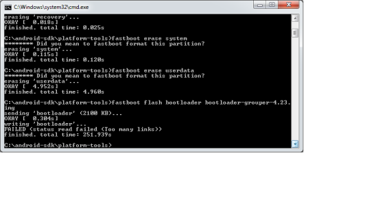

Hi really useful instructions. I got as far as bootloader img stage on command prompt and it came up with an error FAILEd stuus read fialed too many links. I have attached a link
