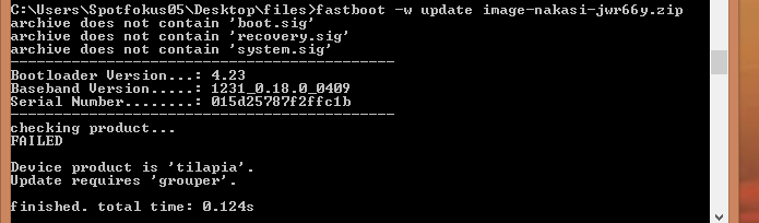

I have a Nexus 7 that only boots in bootloader mode and from there won't do anything. Trying to boot gets the message "booting failed".
I tried installing the factory 4.3 but 'checking version-bootloader failed' version is 4.18 update requires 4.23. So I tried installing factory 4.18 which worked but the tablet still only boots in bootloader and nothing works there except the "booting failed" message.

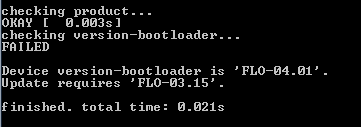

Hi I updated my Nexus 7 2013 32gb LTE to 4.4.
I would like to flash it back to 4.3.
When I try to flash it with the Nexus Root Toolkit v.1.7.9 from WugFresh I get the following message.
Apperently my Bootloader is Version 4.01 and to new!?
I read that I could try to set the tool to force the flash and ignore the warnings. I am unsure if that is a good Idea. Could somebody please help me? Either with a better method to get it back to 4.3 or with a way to flash it with the NRT.
