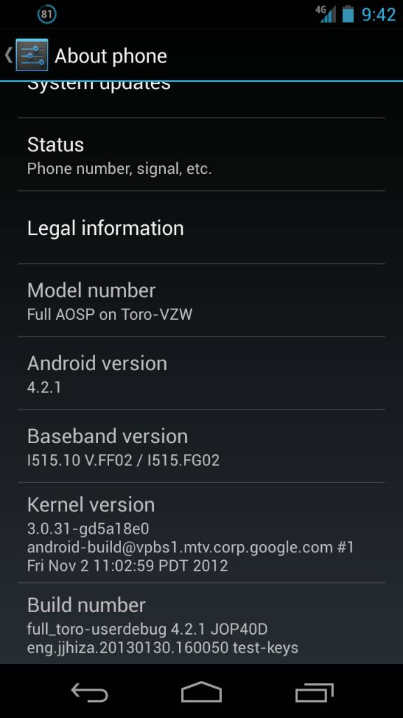

Hey guys! I finally got all my issues worked out, and have compiled a 4.2.1 build that flashes, boots, has root, and all...THANK YOU for this guide!!! :D The only issue I'm having at the moment is that radios are not included in the source, which leaves me with no signal of any kind. I have the radios, and I could flash them, but I'd rather build them into the ROM...Is there any way I can do this? If so, what is the path that I should drop the "radio-cdma.img, radio.img, and radio.img.p" files into (.../vendor/samsung by chance)? Thank you again for all the help, and thanks in advance for any feedback!
Update: issue resolved! :)
