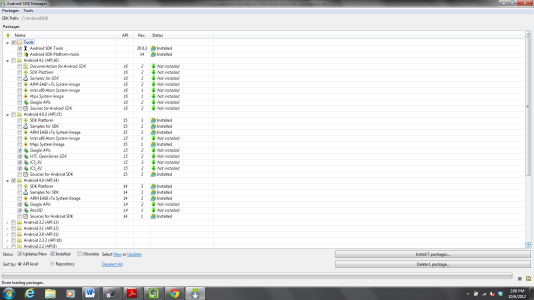

Thanks so much for the guide Mr. Smith, I'd be completely lost without it. I have a very noobish question for you though - when I initially download the Android SDK Manager, which APIs do I need to install? I went ahead and installed the 4.0.3 and 4.0 stuff. Here's a screen shot - am I on the right track or are there files still missing that I need? Thanks!
if you go to the htc dev site and follow every step this will answer your question
