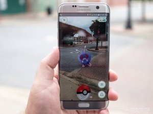

Sensors are dull, boring... rarely mentioned. But they often have a massive impact on how our phones operate. We usually only become aware of them when they DON'T work... a case or screen protector blocks the proximity or light sensor, for instance. And it is often one of the key differences between a top of the line model, such as the Nexus 6P with one of the more budget minded phones, like the Honor 5X. And with the increased visibility of Virtual Reality and Augmented Reality... such as not being able to run Pokemon in AR Mode. (don't worry, Pokemon references will be limited)

Detects angular speed (rotation) with respect to the three axis of the device, reported in degrees per second. This sensor is critical for VR and AR applications, like Google Cardboard or Pokemon and some current or older lower end phones (like the Honor 5X, first gen Moto G) lack one. Without it, there is no way for the phone to accurately synchronize the orientation of the phone (and what you see through the camera) and the orientation of the application's interface.​

A calculated value to determine what direction the phone is pointed, given as a rotation angle and axis. If you can't turn on AR Mode so you can take a screenshot of that Weedle jumping on your gramm's head, blame your phone's inability to determine its rotation vector.​
