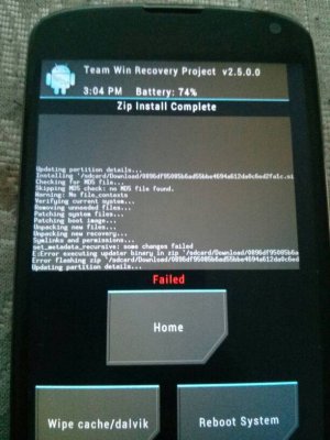

Followed your instructions and this is what I got.

Your TWRP version is outdated. Techerrata Downloads - Browsing mako
Use fastboot to flash it, if you don't know how, rename the twrp img file to "recovery.img", put it in my flashable recovery package, and flash it, then reboot recovery.
Or just flash the stock recovery and use adb sideload to flash the OTA.
