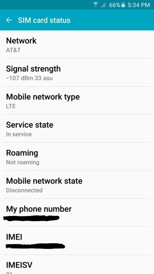

All my calls are crystal clear on both ends and since I have had the N920i I don't believe I have dropped a call. The problem is that I have only 1 bar or -107 to -111 dBm. This is a problem because it is killing my battery life.
Here is a screen shot not talking on the phone, it is on standby. When I place a call the "Mobile Network Type" line says HSUPA instead of LTE and the signal on HSUPA is in the -99 to -103 range.

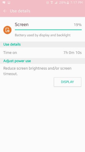

I live in NYC, public transportation (under ground trains) kill the battery. So, when I add the transit with overall bad signal outside, my battery goes to sh**
At work or home I get around 7 SOT and when I have a lot of traveling I'm lucky to get 2.5. But this has been a problem since the galaxy S4 with AT&T.
What is SOT?
