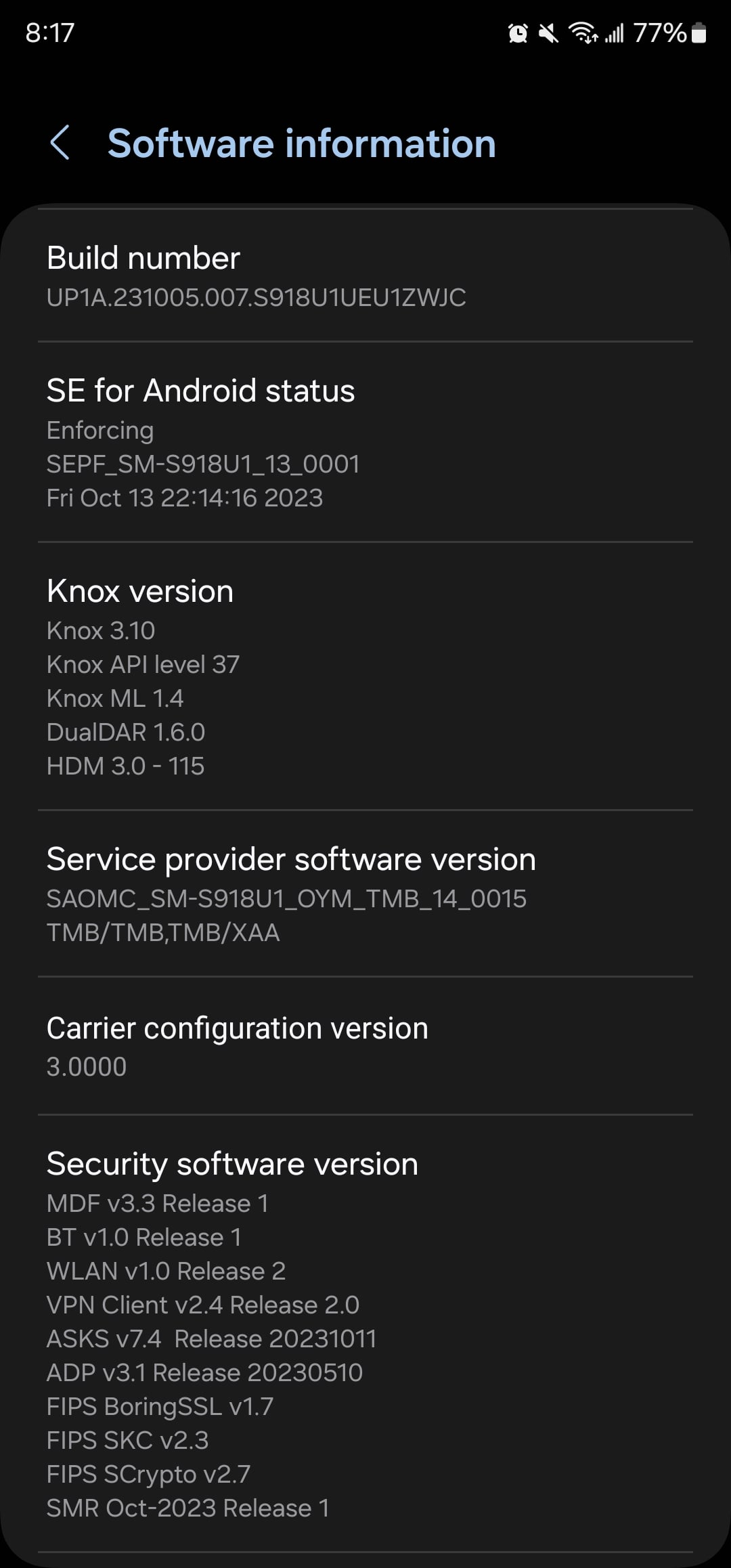

This my s23u unlocked firmware U1 from Samsung with T-Mobile sim
The model code will change once you flash to U1 it's different from the carrier version as well as build number the carrier firmware can have different build numbers between carrier depending what they alter but unlock U1 firmware will be the same no matter what sim is in the device

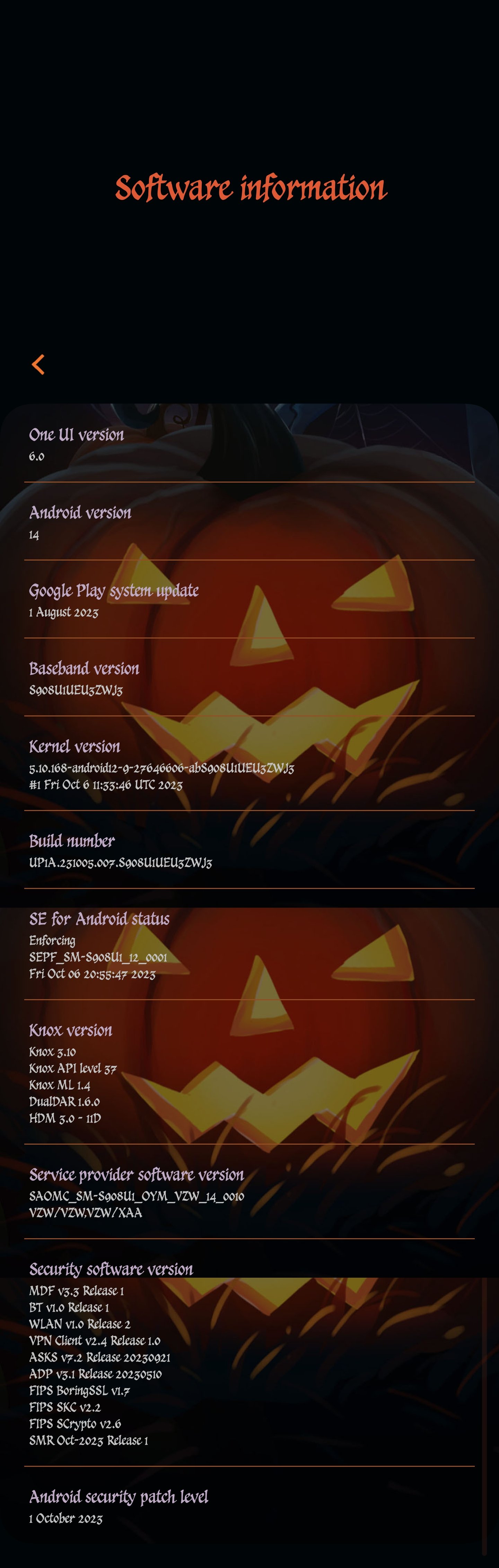

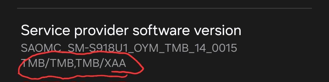

VZW/VZW/VZW/XAA = it was originally U1 firmware
VZW/VZW/VZW/VZW= it was originally carrier version Verizon device
By the way when you see the fourth VZW means it has Esim the device
First 3 is the carrier sim in the device
So if you unlock your Verizon carrier device to work on all sims and u put a TMobile sim it would look like this
TMB/TMB/TMB/VZW
