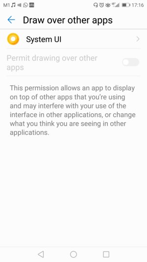

Can you please help me, I'm unable to change the setting, it seems like its disabled. I can't drag the icon to allow System UI to Draw Over Other Apps.
The problem is with the screen overlay and permissions.
Open settings , go to Apps . under apps click on the wrench tool (settings icon)
Under that go to draw over other apps.
Click the menu option and select show system apps. Turn on screen overlay for system UI app.
This should solve your problem. The reason this happens is because you aren't allowing the system to display warning messages or prompts since overlay is off. So it force closes instead of handling the exception and displaying a message.
Thank u so much it worked for me.
