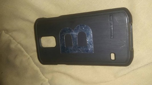

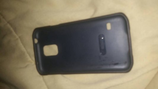

You guys have some serious protective cases on your phones sheesh. I use a thin boby glove case. The raised border keeps the phone from falling flat on the screen. And it protects the back. I wanted to keep that thin feel and I didnt want anything on this great screen. This case has been on this phone since april. No problems. I used lifeproof and otterbox when I used I phones. This phone is quite more durable. But to each his own..
