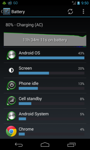

Hello,
I've installed the latest update 4.3 yesterday and noticed that my battery is draining very fast now. Prior to the update, my battery life was pretty good. Last night before going to bed it was fully charged 100% and this morning when I checked the phone it was already at 79%. Under battery usage android OS is around 43%, then screen is next highest with 20%. I tried rebooting several times, called google and they had me do the same thing. Any help would be much appreciated.

I think there is a misbehaving app. I am going through the same problem as we speak... Clean reset... The battery life was pretty darn good.. Once I restored my apps.. the phone is not going to deep sleep... I am using better battery stats from xda to find the culprit.. Basically the kernel wake locks are causing the drain I my case... I need to find the bad app that's causing it.

Don't have Tunein Radio. But here's what I did. I rebooted and charged again up to 100% and now it's back to normal!! Android OS is using 6%. It seems to have fixed itself. Very strange. Thank you for the helpful ideas.

I don't think I've ever seen any other service or app use more battery than the screen. saying that, i would say your Android OS usage is too high and something in there is draining your battery more than it should. Here is a screenshot of my phone right now with 4.3... for me I have found my battery performance to have improved.
