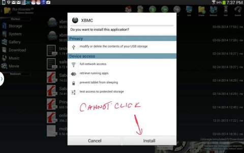

Hey everyone, I purchased 2 Samsung Galaxy Note 10.1 (Both 2014 editions) for my parents for XMAS. Everytime I go to install a third-party app off of sites LIKE Aptoide, I get to the INSTALL screen, but cannot install the app. I personally own a Note 2 and have owned other Android devices before where all you have to do is check the 'Unknown Sources' box in settings and everything works fine. Can anyone help with this? Also, ROOTING is not really an option here.

Do you get any kind of error screen? I have mine and I can install 3rd party APKs without issue, as long, of course, as the APK is the right version for the tablet.
No error screen at all. I just get to the screen in the image and cannot click "NEXT or INSTALL." The image is from one of the Note 10.1 2014s and is running Jelly Bean 4.3. I was able to install the same 3rd party app on my Note 2 with no issues. I cannot install the "Aptoide" apk either. Gives me the same problem. And yes I do have the the "unknown sources" box checked.

I figured it out. My father had installed a blue light filter and it was interfering with the touch response...

Interestingly, the first blue light filter app I looked at had just brought out an update to turn off the filter when installing 3rd party apps, so presumably you're not the only person to have spotted this.

Yeah, it turns out that Android disallows installing while a filter is active. I thought that was stupid until I realized that a filter could alter the text shown on a button or do other insidious things. But Android should tell you that! And no need to uninstall your filters, just turn them off temporarily for the duration of your app install. As dashdashdot says, there's at least one blue light filter that has a setting to auto-disable itself when you go to install something.
