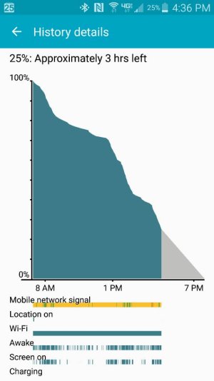

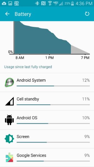

So I have been reading all these posts and complaints about battery drain from the new Lollipop update. I usually can get about 8-14 hours on one charge, depemding on usage. I would consider myself a moderate-heavy user of my phone during the day. So my question is:
Can someone please look at these pics of my battery (below) info and tell me if the stats look normal or compare them to your battery?? If my battery looks weak, any advice on how to improve it other than the usual advice people post on here like: restart or reset, sync, GPS, WiFi, safe mode, screen brightness, etc. Any help would be VERY VERY much appreciated!! Thanks!
Sent from my Sammy Note 4
It's kind of hard to say what's normal, but I think the main question is --- how does this stack up to when your phone ran kit-kat? Is it worse, better, the same or sometimes a mix of both?
For me, I find that my battery life on lollipop is either exponentially better or horrendously worse, depends on the day.

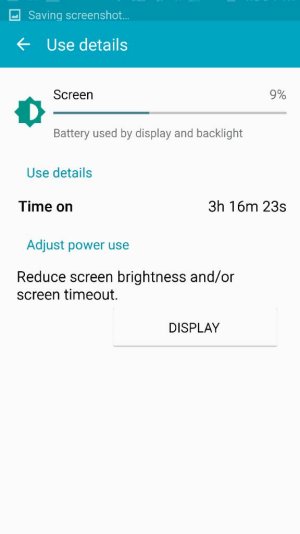

From what I see the screen wasn't on that much so that's why android would of used more battery. You've been mostly in standby. Also check for wakelocks that are keeping your device awake

With Lollipop (my first phone with that OS) the Android system takes 5% of the battery, Android OS 5%, Google Services 4% and the screen is 4%.
On EVERY other phone the screen has ALWAYS been the biggest battery hog, now the Android OS and Google is 14%????

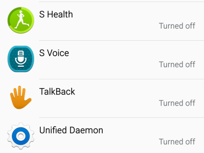

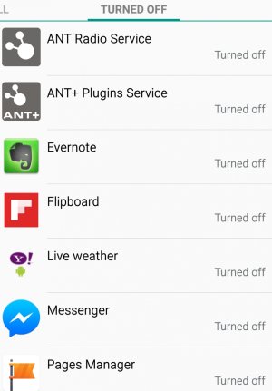

This is what I disabled and now I get decent battery life.
I have completely normal usage except for turning these off.
