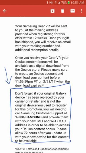

I've received an email from Samsung saying that I need to call them once my Vr sets come in, if I have a different phone than what I had when I signed up for the freebies on there promo site. I did a loaner s7 edge to get my vr set so now I have my note 7 back. Samsung stated they need your current imei # to download the app. Could this be similar to your issues? Just thought I'd throw that in there.
