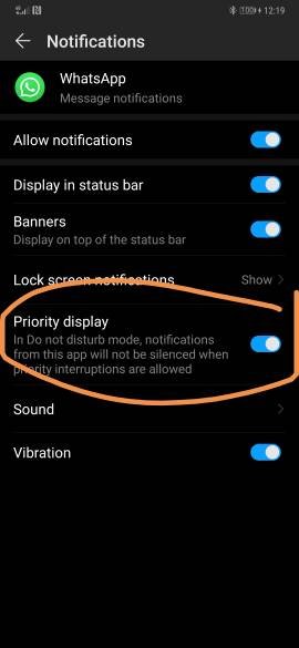

Make sure you have those apps set as 'Priority' in the notification settings. That made a big difference for me for apps I had issues with
