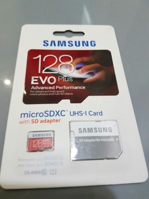

Well, this is my second tablet in two weeks with the same thing. This is the SD Card I'm using. I guess it's a good quality card as I've never bought one before.
Maybe it's the card.... ;)
Be careful moving apps to the card. Apps that need to start with system startup may not work right if the partition isn't mounted yet in the boot process.
SD cards can be corrupt, defective, or counterfeit. Install SD Insight to see if the card is genuine or counterfeit. Counterfeit cards are programmed to report more storage than they actually have, and if you try saving more than the card can actually hold, then files can start getting corrupt.
If it's a valid card, then go to Settings>Storage, Unmount the card, remove it, and insert it into your computer. Can the computer read these files? Backup as much as you can right now, then run chkdsk to look for bad sectors: http://forums.androidcentral.com/am...guide-using-chkdsk-fix-corrupted-sd-card.html.
