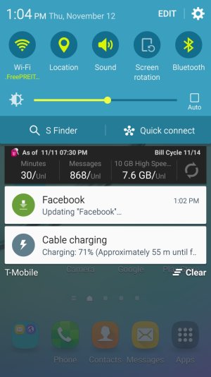

when connected to a PC, the notification says "Charging"
if i tap charging . it does nothing..
it was working fine few days ago...:mad:
how can i change charging to mass storage or camera or something.
In your screenshot, what happens if you tap on "Cable Charging"? Does it bring up any options?
