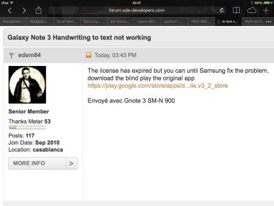

HELP NEEDED! handwritten text not working on note3
hi ....im also from indonesia
and im having the exact same problem
this is really bad.... i really like the stylus
hope they will fix the problem
There was actually a bug.
Just need to have the Samsung Keyboard software updated to the latest version, everything would work perfectly fine again.
PlayStore: Samsung Keyboard Note 3 and update and it should work again.
