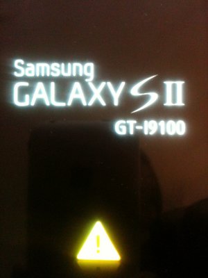

superuserApp)... and a POP-UP Window appeared. Now I really can't remember the exact message but it basically was asking me if I wanted to perform some sort of conversion. Without giving it too much thought and like an ***** I just clicked on YES. The phone then rebooted and remained STUCK on the screen where the "Samsung Galaxy SII GT-I9100" message flashes up with a yellow triangle exclamation mark below (please see attached pic). It doesn't matter how long I wait or how many times I reboot the phone remains stuck on this screen.
Please note the following:
-- If I press (Volume Up + Home button + Power button) simultaneously the same screen appears (ie the Samsung Galaxy message) however long I keep the buttons pressed.

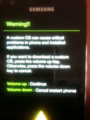

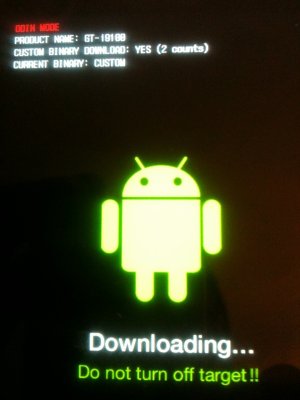

-- If I press (Volume Down + Home button + Power button) I get something different happening ie A warning message about custom OS (see attached pic) and when I press the Volume Up button to continue I get the screen with the Android symbol and the word downloading below it with some ODIN Mode information at the top of the screen (see attached pic).

The volume up, home and power from a powered down state is recovery. Try pressing that combo, but releasing when you see the samsung logo. If you get into recovery, try clicking clear cache partition. If that doesn't work, try again and do a factory reset.
