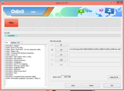

I am now stuck in "failed attempts" grrrrr......tried many times, using different USB ports and cables, redownloaded the firware 2 times....don't know what to do. Using Odin version 3.10.7 and firmware 4.4.2 for the right model and the right carrier. Should I try custom OS or should I just do a factory reset in stock recovery ?
Here's my last attempt info :
