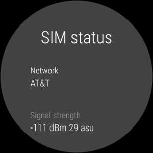

Help with getting Text Message notifications.
I am on AT&T.
But there is no option for NumberSync despite the fact I am on ATT. It disappeared after I did the Call Setup and Rebooted.

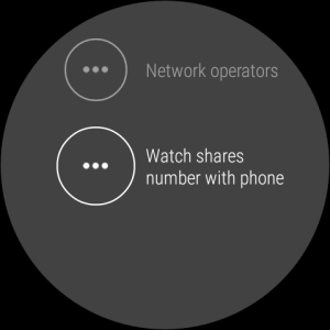

Still No Watch Shares Number with Phone Option
For those with ATT's Numbersync turned on, under that option does it have Calls and Text turned on? or is there even an option?
There is no such option. I don't even have the account option. That probably is added by Verizon Message+ app.

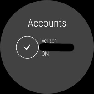

Thank you again, Foxbat for checking. I agree, it probably was added after the fact. So it probably isn't a ATT SIM issue.
So KOAO, is your Verizon phone number listed under the accounts tab?
awwww **** lol.
I would go through the messaging+ set up again but maybe use wifi on the watch rather than with the ATT SIM card. If that doesn't work, then I guess it is an ATT sim issue where they are preventing you from accessing those options.
I would remove the ATT sim card all together while you set it up and use wifi only. I would disconnect my watch from the messaging+ app and unsubscribe from integrated messaging. Do the whole processes with messages+ and see if that give you those options in cellular.
Sorry for not being able to get this working for you. It sucks.
I Can confirm it is an ATT Issue, once I removed the sim this showed up.

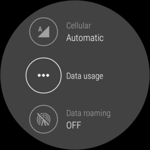

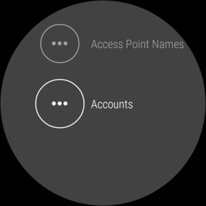

Basically, this means that I am going to Stop by T-Mo tomorrow. json405, You mentioned somewhere that you are on the Wearable plan right? Did you pull your sim from a Gear S or did you go to the store to get it setup? And how much does it cost?
