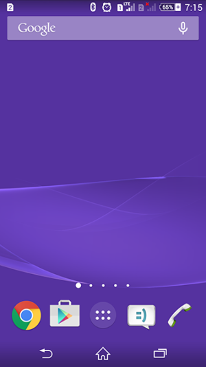

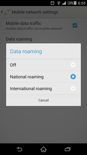

Depending on your preference, if you want the LTE icon/notifications instead of 4G (which is used in Europe), you need to flash your phone to a different country firmware. Also depending on which one you have, you can also select the kind of roaming too.
