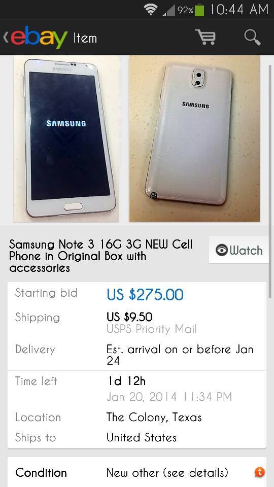

On December 30th of 2012, I purchased a "Samsung Galaxy Note 3" from eBay.
What I perceived to be a real phone, in my ignorance, was actually not. The details of how I came to understand this are chronicled HERE.
So how can you avoid being in this situation from the get-go? Here are some tell tale signs:
Please note that while some of these are "obvious" to an experienced or just a casual online shopper, some people aren't as savvy so read through this objectively.
1) Automatically disregard any listings with the word "clone" in them. They're being upfront with you. You WILL receive a visually convincing look-alike and will NOT be able to return it by claiming it's a counterfeit.
2) "Smart Care" stickers. As far as I'm aware, none of the original boxes are supposed to have this sticker. The knockoff I have has it, as well as knockoffs I've come across in my research. If someone has an original Note 3 that came in a box with one of these stickers, you may correct me. I'm not 100% sure on this bit. UPDATE(04/09/14): I've been informed that there are genuine boxes with smart care stickers, but I'd be wary of one with the sticker. Make sure everything else checks out.
3) Missing accessories. Not every eBay vendor has a picture with the box opened, but if there is, look for the bag with the S-Pen nib replacements. If you can't see it, there's a chance the phone is counterfeit. As seen in the above picture, the bag isn't there. If you're curious to how one looks like, here's a picture of mine:
4) Look at the details in the description. Google the model you're looking at on eBay and see how the specs listed stack up to the verified information. Main things to look out for are storage capacity, RAM and display resolution. Storage should be 32GB or 64GB. Resolution should NOT go below 1920x1080. Ram is a little more flexible throughout all the models so make sure you have the correct one. The reason I'm stating this is because if the seller is unaware that they're selling a counterfeit(and aren't tech-savvy), they'll list all the original information. If the seller is intentionally trying to sell you a counterfeit, they'll state the lower specs and you will not be able to claim you were unaware that the phone was not an original.
Other things to consider while you're looking at the details: Some Note 3's only support 3G as opposed 4G/LTE. This is because not every country has 4G/LTE technology and the international versions sent to these areas don't support 4G/LTE to cut production costs. The phone itself will not suffer and performance will be near identical to other models.
5) Double check "Unlocked Phones". You should double check everything anyway, but I've found throughout my scavenging that the fakes I've spotted all claim to be Unlocked. It's not to say that there aren't legit Note 3's that are unlocked, but there's a higher chance of the handset being a fake if it's "unlocked".
6) Ask the vendor for verification. If you're still unsure after taking all of those steps and still want to buy the phone, there's something you can do to make sure you'll be covered by eBay's buyer protection. Send a message to the vendor(search for the link that says ask a question) asking the vendor to verify that the phone is an original Samsung Galaxy Note 3. WAIT FOR THE REPLY BEFORE BUYING THE PHONE. If the vendor says yes or that you can buy with confidence, go ahead and purchase the phone. This message will be kept on eBay's servers and can be used later as evidence in case the phone is a counterfeit.

It looks like someone is at it again...

So it said "CLONE" in the title and you were not aware it was a fake?? Or simply did not read the title.
No, in my case, the seller was not aware the phone was a clone so it was listed as an original Note 3. I briefly touch on this subject in the first post, but don't go into too much detail. Honestly, not ever eBay seller is out there to get you and they're just making honest mistakes, but there's no real way of telling. I gave mine the benefit of a doubt.
Thanks. :D
