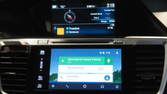

I'm actually interested now you that mention it. In the Accord, what do you mean by split screen with AA? Does it just display the USB audio info on one screen and navigation on the other? Just wondering.

The accord has an upper and lower screen. The lower screen is a touch screen and works like any other AA interface. The upper screen is configurable. In one configuration, the screen has 3 areas. The top right has info like MPG and Range; the bottom has title/track information from whatever audio source - including AA audio sources; the top right usually has an image of a compass showing direction but if you are navigating w/ google maps it will tell you next turn info: arrow, distance countdown meter, street name.
here is an image I plucked from google images. You can see the 2 screens and the track info in the top screen. The compass is shown here but that part gets replaced with the next-turn arrow when navigating.

Ah, very cool. Do you need to have the navigation system in the Accord for the directional info to show on the second screen? Or is AA able to pass that through even without it?
