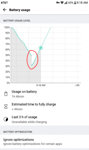

Anyone else having issues with their phones? I charged mine this morning, went 2 miles to work and I noticed my pocket was hot. I took my v20 out of my pocket and the screen was on, the battery had dropped to 94%. Turned it off and set it on my desk, the battery was at 94%. I checked on it an hour later, still blistering hot, 49%. Popped out the battery, let everything cool down, put it back together, 31%.
The battery drain on this thing was already pretty terrible. But 69% in an hour and a half with the screen off it a nightmare.
Thanks!
These were taken after rebooting and charging for a while.
Is this where you pulled the battery and inserted it again, showing an 18% drop while OUTSIDE of the phone?
If so, then replace the battery ASAP. It likely has an internal short. This would account for the drop and excessive heat, and can potentially be dangerous. If it gets worse, it could cause the battery to catch fire. If you have another battery, use it until you get this one replaced.
As for what to do with this one? Ideally, you'd want to put it in a fire resistant container and seek out a way to discharge it to 0V. Note that your phone will not do this. It will shut off while the battery still has some charge left in it. There are DIY ways of fully discharging around online. Some safe, and some dangerous (I.e. Driving a nail through it), but don't use the salt water method (it just corrodes the terminals, leading to a false zero voltage reading). If you can't do it yourself, then seek out a place that can. Don't just drop it into a random battery recycling bin because of the fire danger.
Looks like Google Play is either updating apps automatically through Wi-Fi (which explains the hot temperature and battery drain) and or Outlook is syncing emails too often. Turn off sync, turn off Google Play automatic updates, turn off Wi-Fi when not using it.
It is the original battery. I bought the phone new at launch. I just put a replacement battery in and it seems like it's doing the same thing.
It seems unlikely that it would be outlook or google play, as a mail sync takes a few seconds and updating apps a few minutes, but who knows. I just booted into safe mode to see if that makes a difference, but it seems like it's still running pretty hot.
If all else fails, I'm going to backup my data and do a factory restore. Otherwise it might be the end of my v20.
