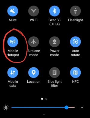

Hi,
Just wondering if on Samsung S9+ you can add a button to Turn On / Turn Off your Hotspot, from the "quick access menu" when you slide down.
This was a standard button on all my other Android phones, so I'm guessing I'm missing something obvious here. But for now, when I click on the 3 dots and go to "Button Order", Hotspot is not an available option.
Thanks!

I wanted to post here in case others have this issue. Like the original poster, I have a Samsung Galaxy (S10 model) and am on the Fido network in Canada. It appears that Fido, along with some other carriers have opted to remove the Mobile Hotspot quick toggle button. Not sure the reasoning behind it, but it's very annoying if you regularly use your hotspot as you have to go through the settings menu to toggle it on and off each time.
I found a video on youtube entitled "How to Restore the Mobile Data and Mobile Hotspot" that worked to restore it. In short, you need to download "SDK Platform Tools" for Android Developers, hook up your phone to your computer, and use the tools it to reenable the toggle. The tutorial I found guides you through copying the current list of System UI Quick Setting Toggles from your phone, adding "Hotspot" to that list, and copying the new list back onto your phone. The hotspot toggle which was removed from the list of toggles by your carrier has now been re-enabled.
From what I read, you may have to do this again after major updates, so it would be good to keep the instruction video in your bookmarks.
And I would place the full instructions here, but TBH the video does a much better explanation than I could do in a forum. Good Luck!
I also noticed the Mobile Hotspot option was missing from the settings Quick Panel on my new Galaxy S10e on Canada's Virgin Mobile (Bell) network. Since I use the hotspot frequently, I was distraught to find it missing. Thankfully, I discovered the "Tethering settings shortcut" app (https://play.google.com/store/apps/details?id=org.logpedia.tether) that fills the void. I've placed the app icon on my homescreen and can now enable the hotspot with only two taps like I could on my old phone. I hope this helps others who are also missing the Quick Panel option.
