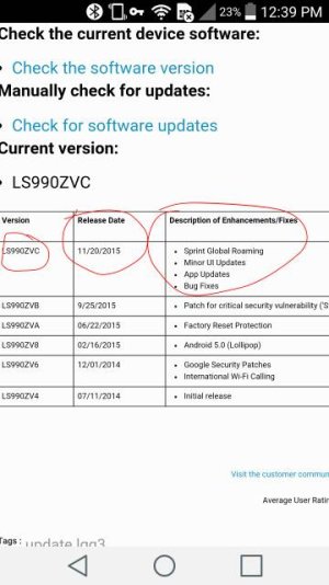

Yes i have tried both. I actually received the update again today,and it failed once more. Sorry about the picture quality on the 2nd photo. I only had a 0.2 mp camera with me. I have also tried updating with lg bridge and other lg software,but the programs never detect my phone is connected but my PC does.I even went as far as to factory reset my phone and try to update,but that didn't work either,so I just restored from a backup. Any other suggestions? Thanks!

Re: Lg G3 update error!
The stock rom you listed for the LS990 lg g3 isn't the latest update. There was an update for it last month. I first received it last week.
